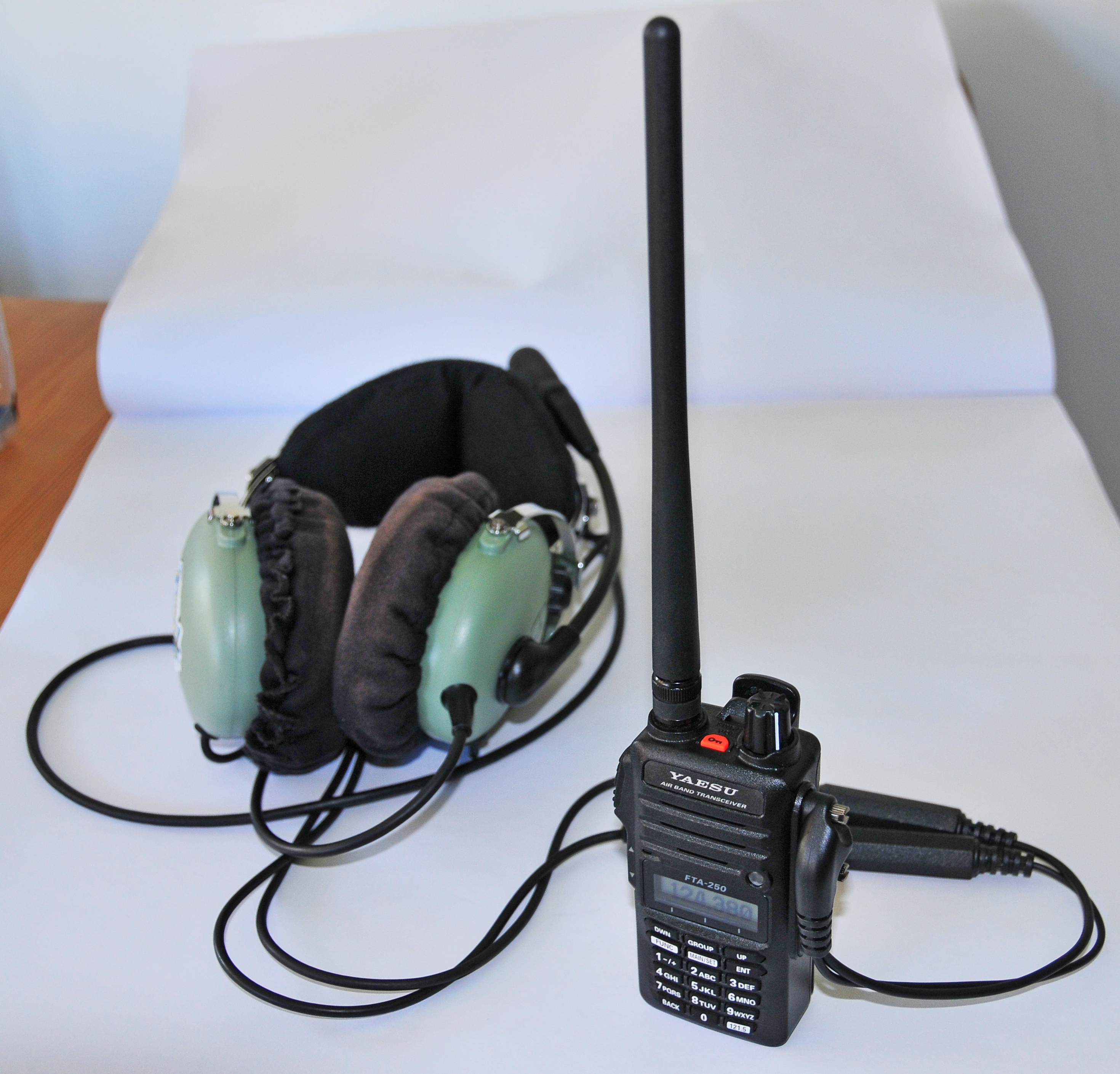

A headset adapter is supplied with the unit and I was keen to test the FTA-250L in the air as a purely stand-alone handheld unit, using the ‘rubber duck’ aerial.
The adapter was quick and simple to fit, by taking two screws out of a rubber side panel and screwing the adapter in. To be honest, I didn’t expect too much and my fears seemed to be confirmed when no-one could hear me. So it was back to the operating manual, which saw me change the mic setting to external and also the sidetone from the ‘off’ default to ‘Level 1’. Hey, presto, wonderfully clear transmission, reception and sidetone via my standard David Clark headset.
