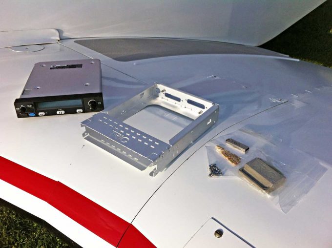

Trig TY96 Radio kit
The Trig TY96 Radio with tray and fitting kit
The only real issue was deciding which wire went where! Fortunately I was able to obtain the information I needed from the installation manual for the Bendix and the Trig installation manual. In fact the manual provided examples which, although not exactly corresponding to my situation, were close enough to reassure me that I was on the right track. There were disadvantages in taking this approach because the TY96 has a built-in intercom which, for example, enables the use of stereo reception if desired. However, I had always been very happy with the Sigtronics, so for me this wasn’t an important consideration.
So far as the actual fitting of the radio was concerned, removing the old tray and fitting the new one was fiddly but nothing more. The BendixKing tray is slightly longer than the Trig so the mounting supports needed adjustment and a few simple brackets had to be manufactured, but nothing beyond my basic engineering skills.
Switching the TY96 on, I was rewarded with no smoke and a bright display shining back at me! A ground radio check resulted in strength 5 both ways and, again to my considerable relief, I was untroubled by either interference from the engine or breakthrough from the transponder. After the installation had been signed off by my inspector, I carried out the flight test using Bristol Radar and everything checked out OK.
